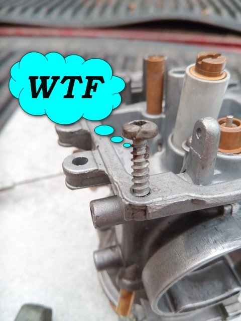

Wow thats great.  What did you wind up doing on that.  You have to be super careful with that situation  to not bark the corner off. If you can’t get a screw that fits then carefully drill it out and use a small screw with a nut and lock washer.
used a electricians tri tap to gradually learn it's threads -it's all good. I put it on this morning and the blue smoke is gone but the carbs popping (lean?) and reving too high with the idle adjuster not even touching the cam. This is where I ask for help. Attached a small clip of her purring. Off to town but going to bring back some refreshments and work on it this afternoon. Hopefully one of you fine gentlemen will have a solution for me..Cheers
