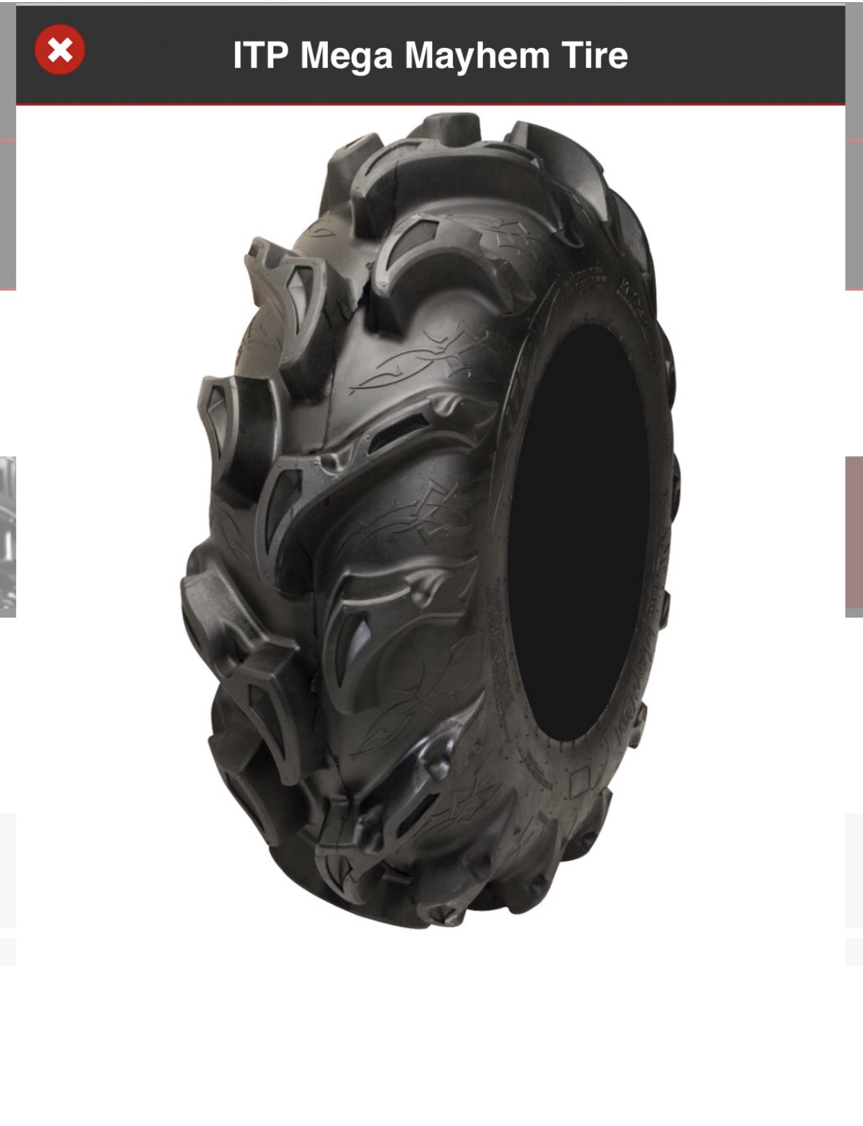

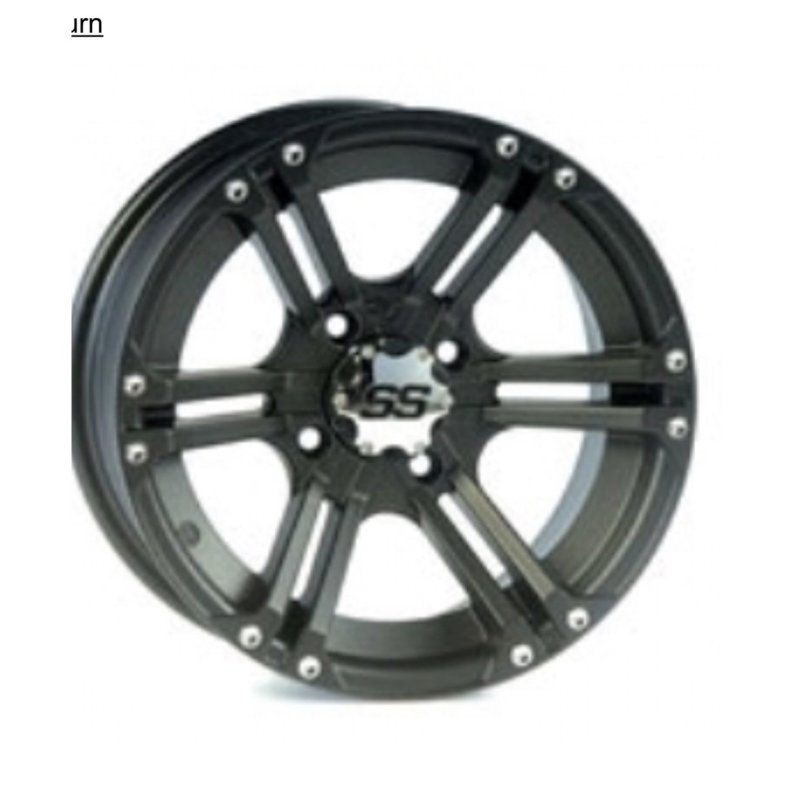

Ok so I think I made my mind up and going to go with a ITP Mega Mayhem tire.
27 inch and most likely up a 2” lift kit while I’m at it.
Going to go with a SS rim black powder coated.
Any objections/suggestions on a lift kit pros and cons ?
Doing the same thing on my sons 350 but staying with a 25 inch tire maybe a 26. No lift needed and a little less aggressive tread.
Got a great package deal of $1,575.00 for both sets mounted, lugs and lift kit for both bikes.  Sound fair ?
I had those SS rims on my Cat, they look nice but they also offset the tires by 2 inches. It made it tricky to load / unload the quad because of setting up the ramps. The tires were on the edge with the Triton trailer and ramp placement for the jumping jack made it a tight fit with both quads on the deck.
I removed the rims last year and went back to standard rims.
Did you order the lug nuts for the rims? They are different the standard lug nuts.

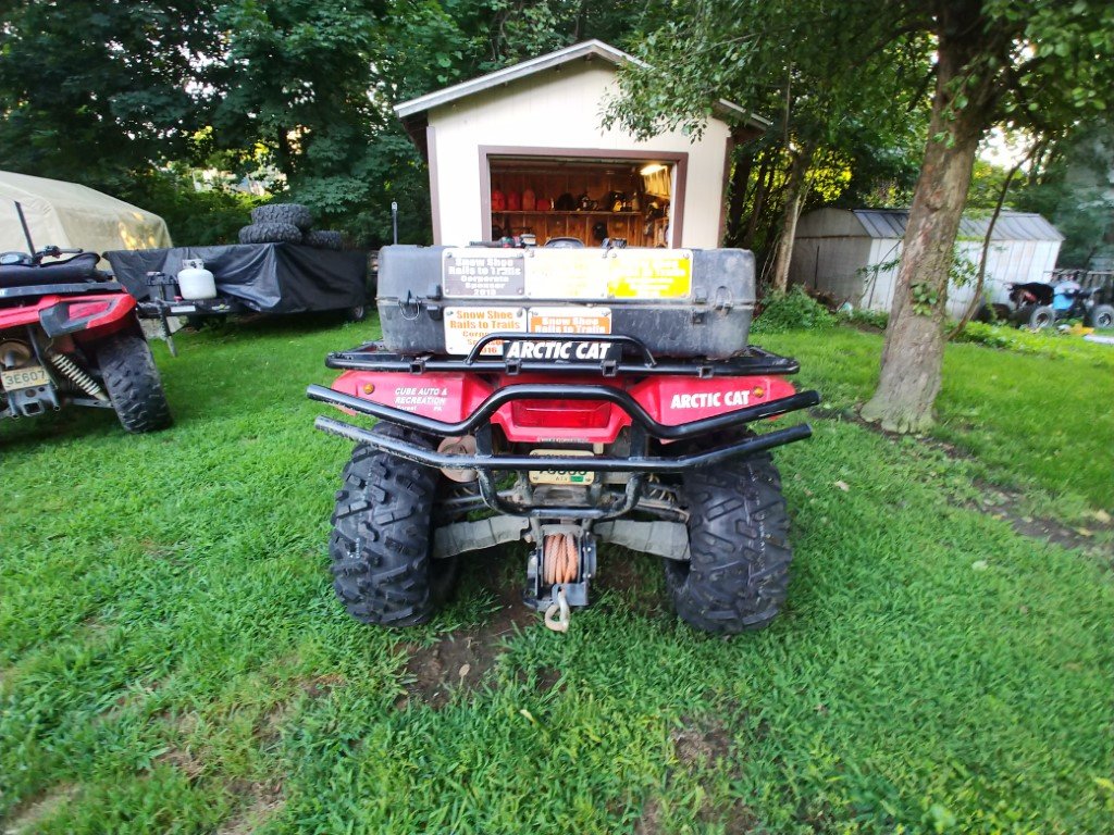

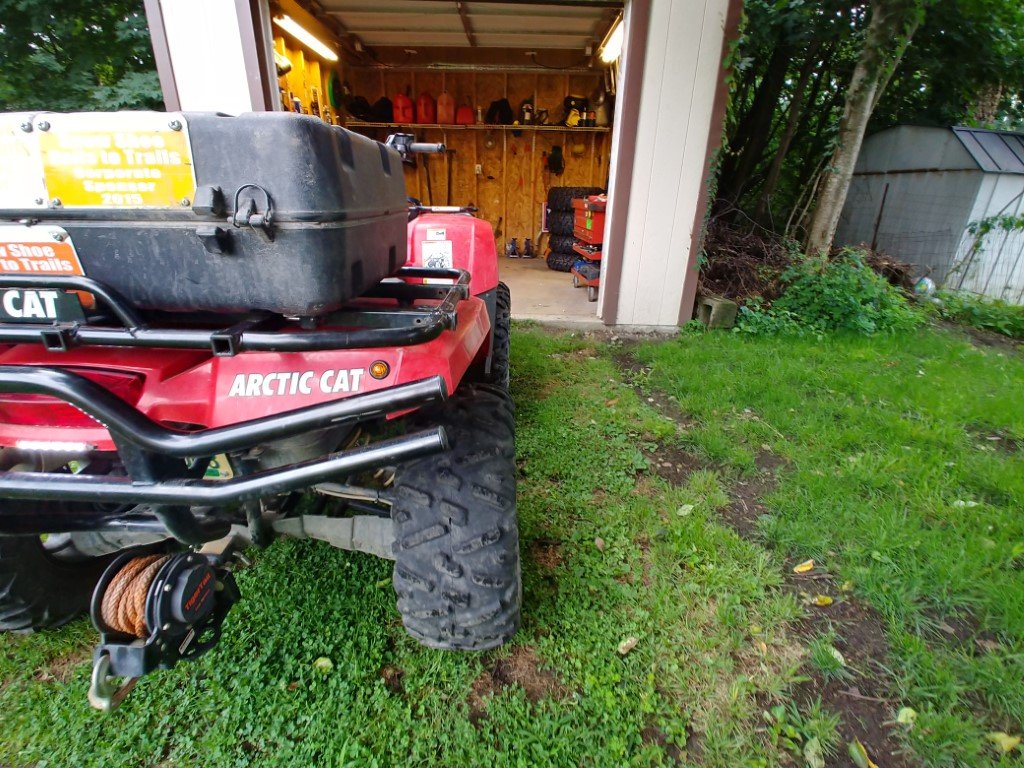

Thanks for the info @mikeexplorer . So the offset makes the bike wider ?
I did order the lug/lug nuts.
Yes, it moves the tires out about 2 inches.  First picture is with the SS rims. Second is one after replacing them with standard rims. What is a bit deceiving is the new tires are also 1 inch wider then the older ones.

Wow I see that!! It looks more then 2 inches. Thanks for the info. I really appreciate it.

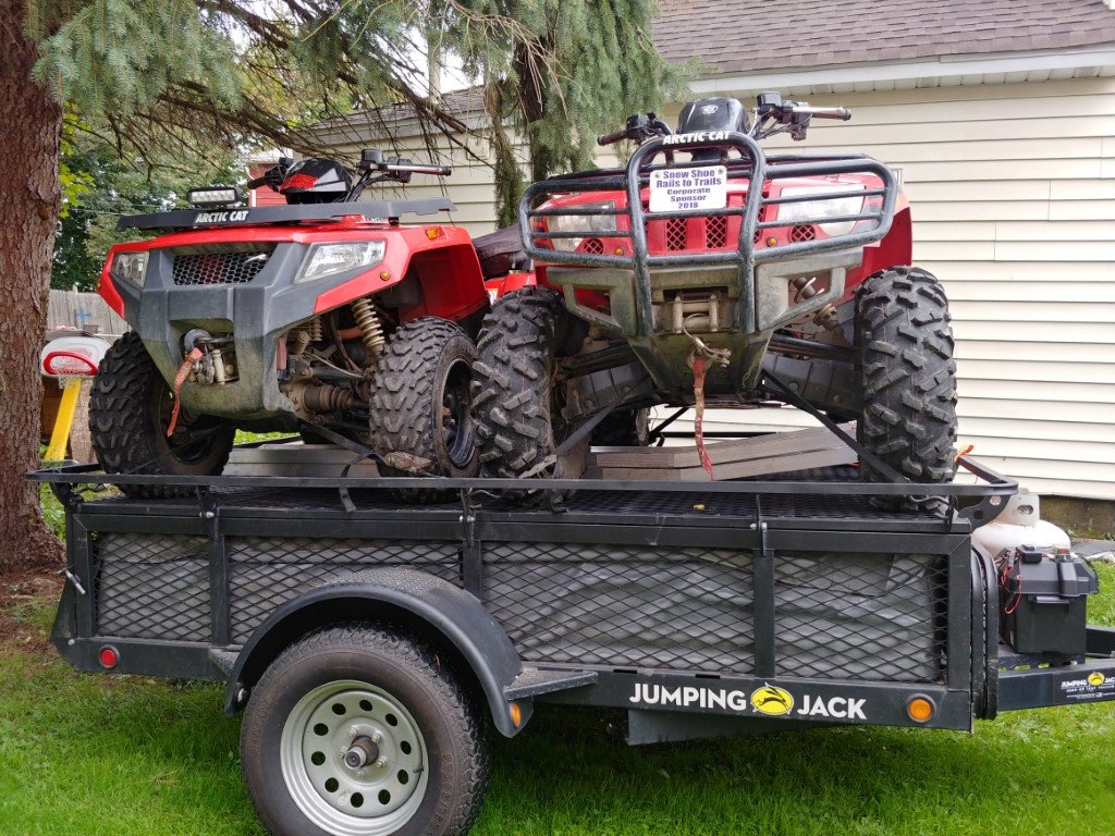

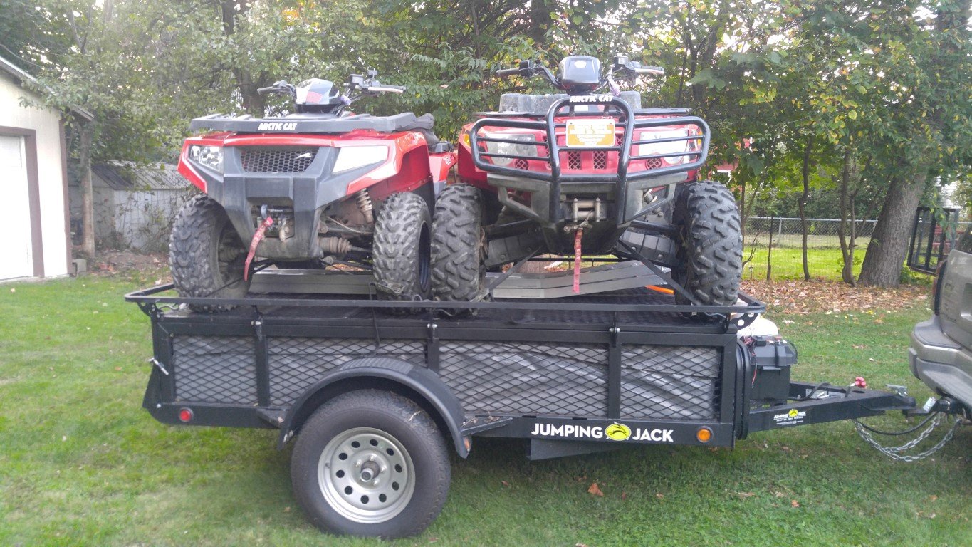

No, its just the camera angle for the second picture makes it look different. These pictures might be better, first one is with the SS rims, second with Arctic Cat Rims.
Where the ramps go to load & unload, it changes how much room I have on the deck of the trailer which although does not look like much, makes a big difference.

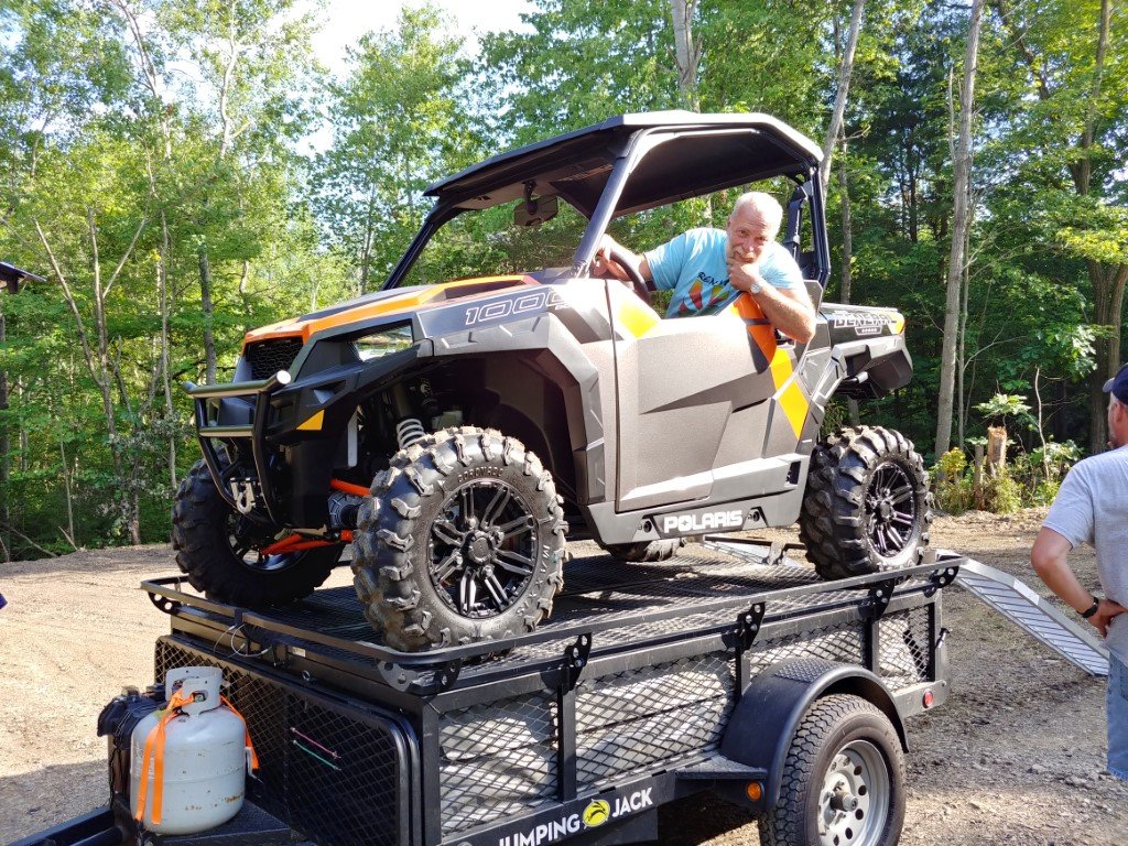

Its working out well for us. It is the 6 x 8 (Standard) trailer. Since I changed rims on my machine, loading and unloading has been fine. This model weighs 1,200 pounds with the trailer plus tent. Axle is rated for 3,400 pounds.
Last year a friend was interested in buying one, so we test fitted his Polaris General on the trail and it fit fine. (This sized trailer is rated for 2,200 pounds on the deck) When he called for a price he was quoted $6,500 for this model. Now there are no longer any dealers on the East coast so what they told him is for $500 they would deliver it to his house.
These are made in Salt Lake City Utah, on the west coast these are very popular with hunters and riders.
