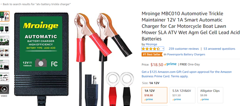

With this cold snap, I noticed yesterday that the battery on my grizzly was a little weak. even clicked a few times before I got it to start. I'm thinking of picking up a batter tender/ trickle charger so was wondering what people use to keep their ATV battery charged up. I was looking at these on amazon. They both have good reviews.
Mroinge MBC010 Automotive Trickle Maintainer

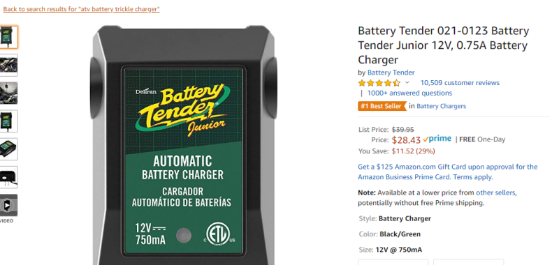

or this one
Battery Tender 021-0123 Battery Tender

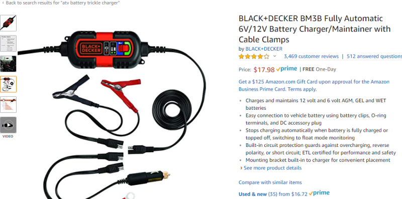

Kind of like this one because if the accessory plug
BLACK+DECKER BM3B Fully Automatic 6V/12V Battery Charger/Maintainer with Cable Clamps
I have the same exact charger as picture 2. It charges the Harleys and my quads and go cart with no issues. Great buy for me. I bought the plug in accessory that bolts onto the battery. Easy to just disconnect and reconnect

I have the regular Battery Tender Plus as well (pricey at $50) that I bought back in 2014. I really like the accessory features of that 2nd one (BM3B) for $19!!

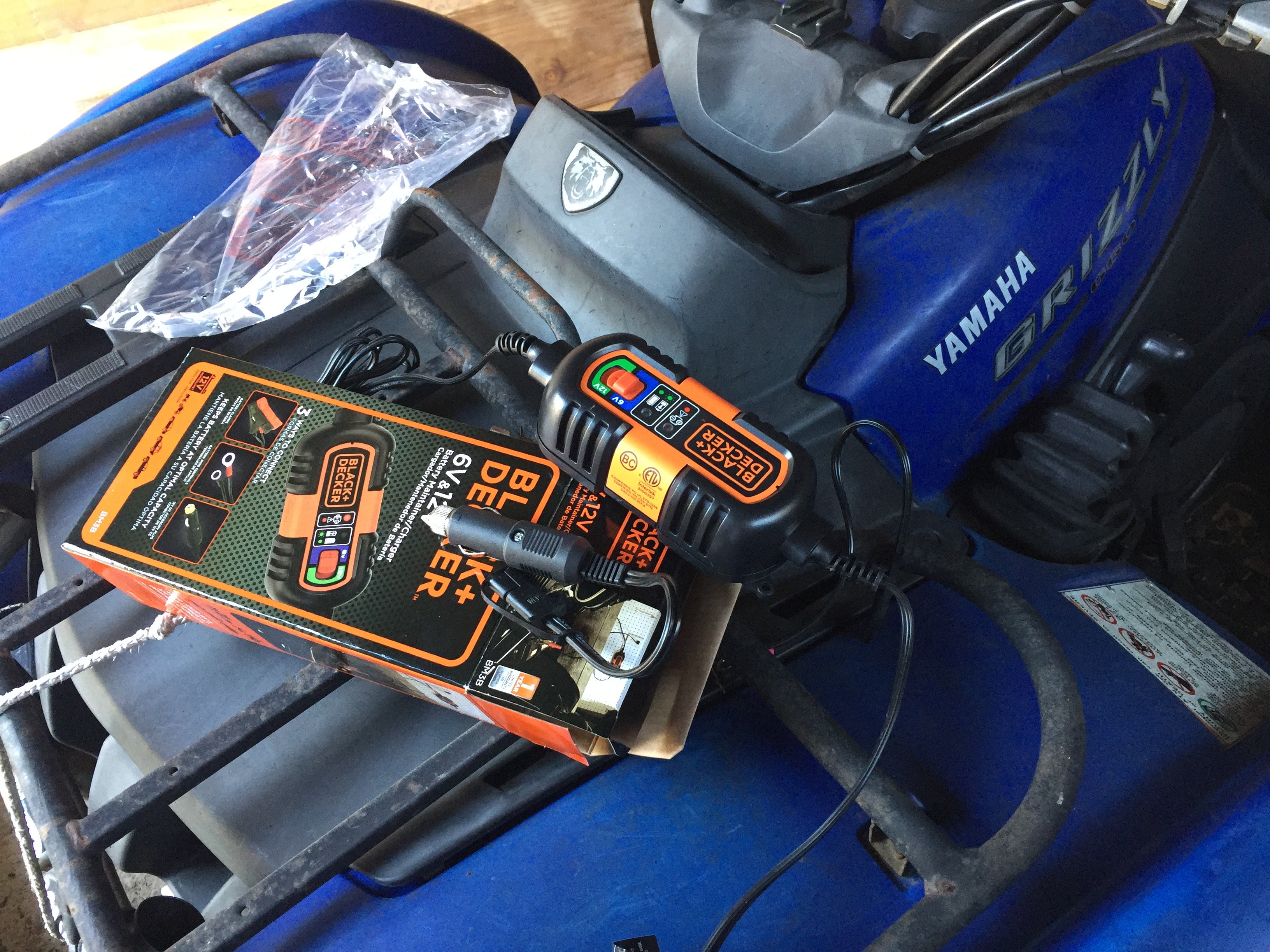

Thanks everyone for the responses! Good topic and very helpful. I ordered the black and decker because of the accessory plug, price, and overall reviews. We'll see how it goes.

The B&D  unit  should serve you well.
I have B&D maintainer then got BatteryMINDer Model 1510 a few years later.  I also had the NOCO Genius which I return after doing some monitoring and it seemed to be overcharging.  The 1510 has a 5 year warranty and has been the best IMO.  It is the only Maintainer approved in Aviation. I rotate the 1510 around once a week between six batteries during winter.  I've tried using the B&D on  batteries after one month of no charger which was last done by the 1510 and it shows the battery is fully charged.  Supposedly the 1510 can maintain multiple batteries that are fully charged in a parallel circuit but I'm not going to try, I just rotate once a week.
The reason I hesitate with less expensive ones which I do own and use the B&D is that my buddies B&D overcharged his 8 month old $120 Harley battery last winter. I only run it for a few days per battery, once a month which is what I would recommend to be safe.  I mainly use the BatteryMinder since I have six batteries not used over the winter months and it has Desulfator which did bring my truck battery back to life and even started after sitting outside at work all day last week at -35. There's nothing wrong with the B&D, it has worked great for my over the last three years.

Good info, I just noticed that my battery was getting weak after sitting..especially when cold out so want to make sure I have juice when I need it. I'll see how the black & decker goes, hopefully no overcharging. I'm going to check it tomorrow.

I forgot to mention that I can't get it to charge through the accessory plug like I wanted with this black+decker, that's what sole me on it...lol. I have to test the plug. I had to use the alligator clips, but works good.
Probably the accessory plug only has power with the ignition key on. Arctic Cats have a 2 pin connector under the rear fender that has power on all the time for attaching accessories. Its perfect for attaching the battery tender. Perhaps your machine has the same connector?

Probably, need to check. Never thought of that.

I am a big fan of the battery tender brand, the are reasonably priced, seem to be resistant to weather, and last forever. I have the smaller ones for my ATV's and lager units for the truck, and marine battery's.  I've had some cheaper ones but the magic smoke leaks out and they never work again.
