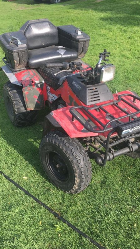

so this is my last resort. My 1984 Honda trx200 does not have spark. Note: I can’t attempt any repairs until 1/2/19
Ill break everything down.

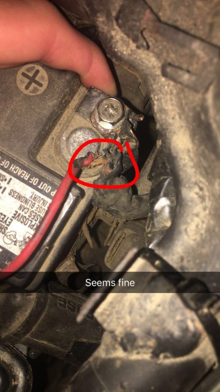

I tested the stator, replaced the spark plug wire/coil. Replaced the CDI box with a known working one. Replaced the spark plug. Also I noticed the positive to the battery had two wires going to it and tied together (see picture below) was butchered. I cut the wire off and cleaned the connection and put the wire on its own connection and attached it to the battery. After all this I still have so spark.

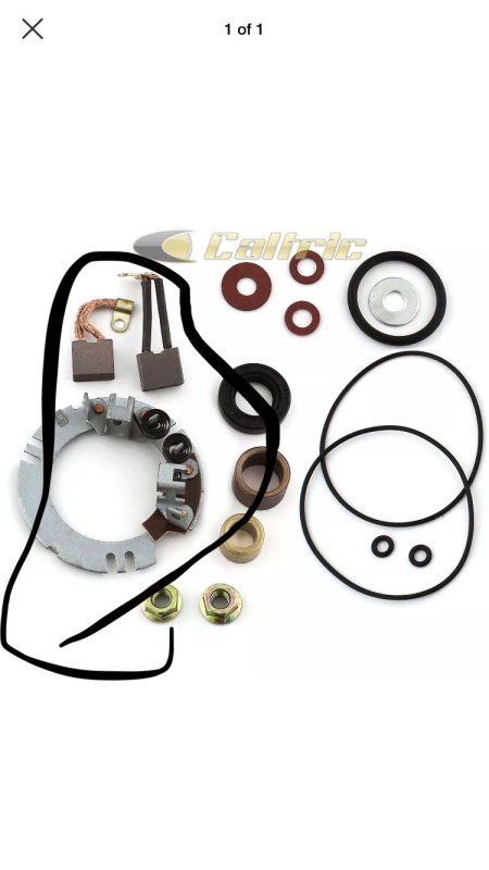

I’m not talking about the actual cdi box computer. I’m talking about this (see pic)
if that’s what your referring to then sorry I  misunderstood.
The voltage spike that you see is the draw on the battery when the engine is cranking.
My guess is the pick up coil is prob on its way out. And since you have to open that cover up to replace it I would replace the stator coil as well.  Especially If you replaced the cdi with a known working one and it didn’t correct the problem.  Have a look at the rectifier ad well.
