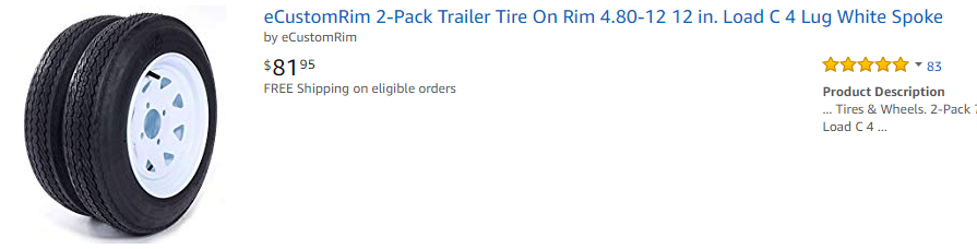

Maybe get those trailer rims/tires combo but as long as you can get a lug patter that works.
eCustomRim 2-Pack Trailer Tire On Rim 4.80-12 12 in. Load C 4 Lug White Spoke
