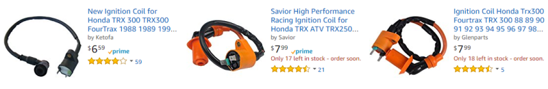

Sweet, appreciate the insight.  I have a coil i'm going to try today, if that doesn't work i'll move to the ECM.

Good call, there's always a chance Stuart Little got in there for a midnight snack...I'm hoping a new coil works for me, if not i'll download the service manual and move upstream to the computers and control modules.
