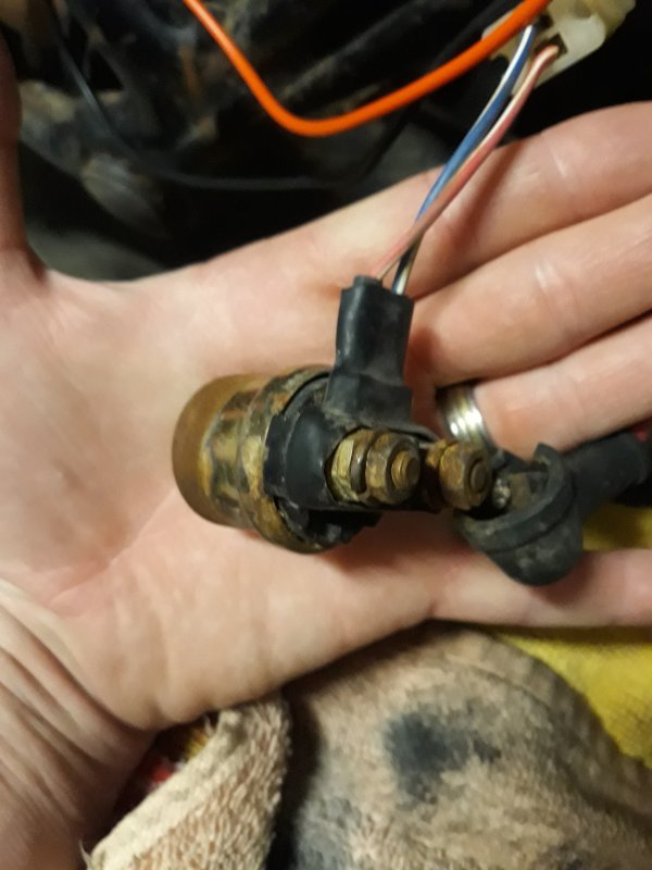

I ran a multi-meter over the stator coil. All three phases came back with the same resistance (1.2 ohms) and there didn't seem to be any shorting to ground. From what I have seen online this suggests the stator coil is all ok?
Starter solenoid is pretty corroded and shot I think but the 'neutral' switch wire was disconnected and looking at the wiring diagram I think the starter solenoid will not function unless there is power from the neutral switch (?). Starter motor spins over when connected to battery directly but doesn't sound like it is "engaging" as the engine doesn't turn over...need to check out what is going on there but if I can get it to pull start then atleast that is a starting point (no pun intended)
I think the ignition coil is busted though as resistance on the ignition coil seemed through the roof so this seemed like a logical issue to me but I am no mechanic or auto electrician so happy to be proved incorrect.
I have not yet checked out the Regulator or starter circuit relay and I believe it is not possible to test the CDI?
Am I on the right track????
Cheers.
Yes you are on the right track.   The neutral safety switch will lock out the starter relay but you can jump it out and test the circuit that way.  As far as the relay goes I would replace it if it’s corroded.  I would have guessed that the stator was bad for sure.  The cdi is a tough and expensive call to make.  Can’t test it.  Caltrec makes a replacement one cheap enough but they don’t work so well.
Yeh the Starter motor solenoid looks pretty crappy (photo attached).
With jumping the starter relay, I assume it is just a matter of crossing the 'in' and 'out' wires, for the lack of a better term... e.g. not the neutral or brake safety switch wires ?
I am located in Australia, so finding some parts is a pain in the butt. However I was thinking of buying the following starter solenoid;
https://www.ebay.com.au/itm/AFTERMARKET-STARTER-SOLENOID-YAMAHA-YFM250-1989-to-1991/272348129240
and I came across this CDI but I am not sure on it...seems to cheap to me.
https://www.ebay.com.au/itm/High-Performance-Ignition-Coil-CDI-Box-For-86-91-Yamaha-YFM-225-250-Moto-4-AU/202471978714
When you say the 'Caltrec' ones don't work so well, what are the issues? or just un-reliable?
Cheers, Brett
The neutral safety depends on the bike.   For instance on my Kawasaki I have two wires coming from my neutral safety switch. So one would naturally assume to splice them. That’s not the case. I had to take one of the wires from the harness and attach it to a ground in order to  bring in the starting circuit.
That relay looks banged up but a lot of the time they are ok.
As far as the cdi goes here’s my take. I have a Yamaha Bear tracker. Stator coil was bad. Replaced it and the bike was fine.  When I ordered that stator I ordered a cdi as well just to be safe.   It looked great and plugged right in but would not work.  It was the right one for the right bike. But no good.  I put the old one back and if fired right up.   I tried it again later the bike fired and shut down.  Put the old one back it fired right up.  It was like it worked some time.  I ordered one for my  fourtrax and it did the same thing.
