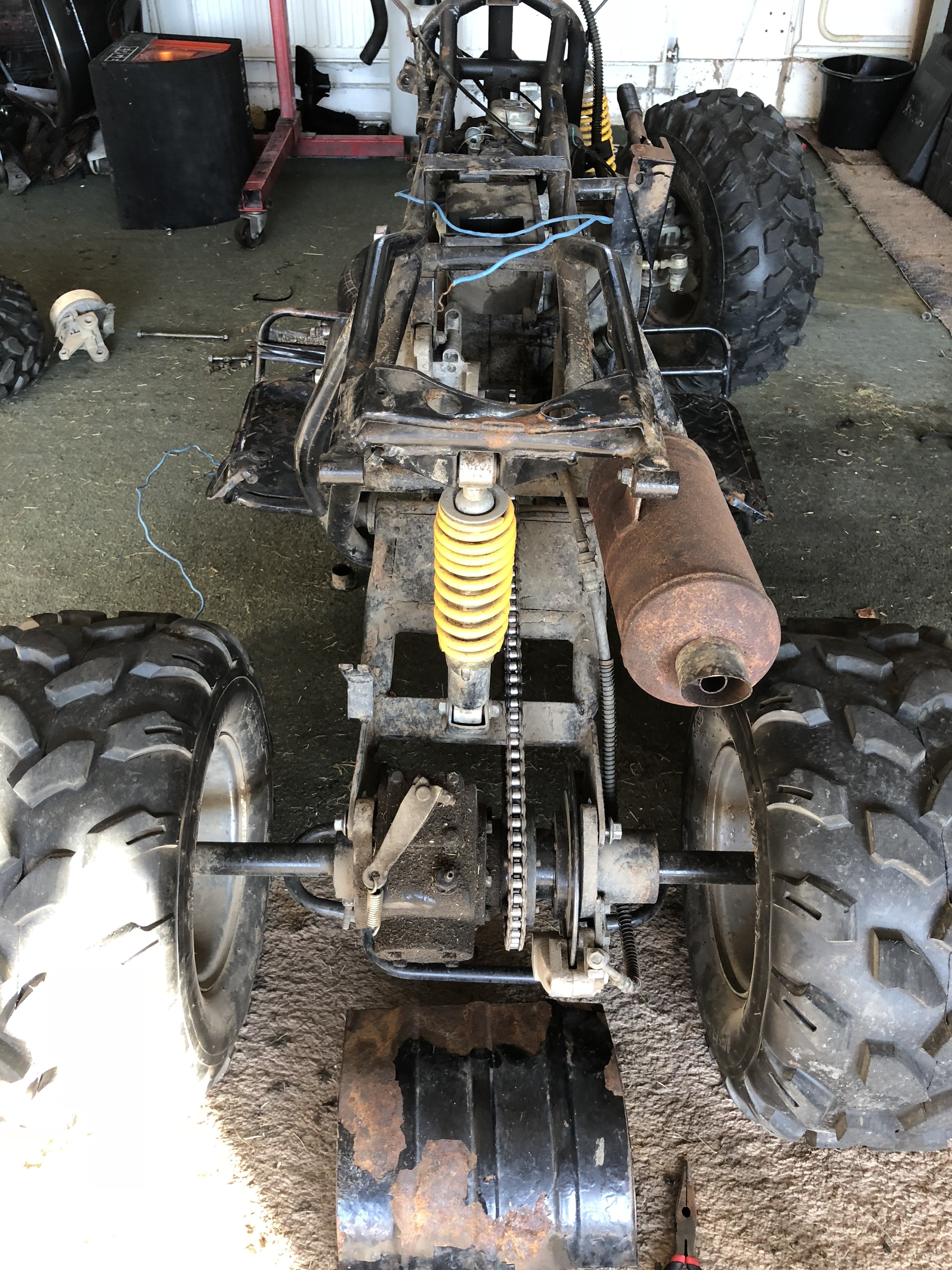

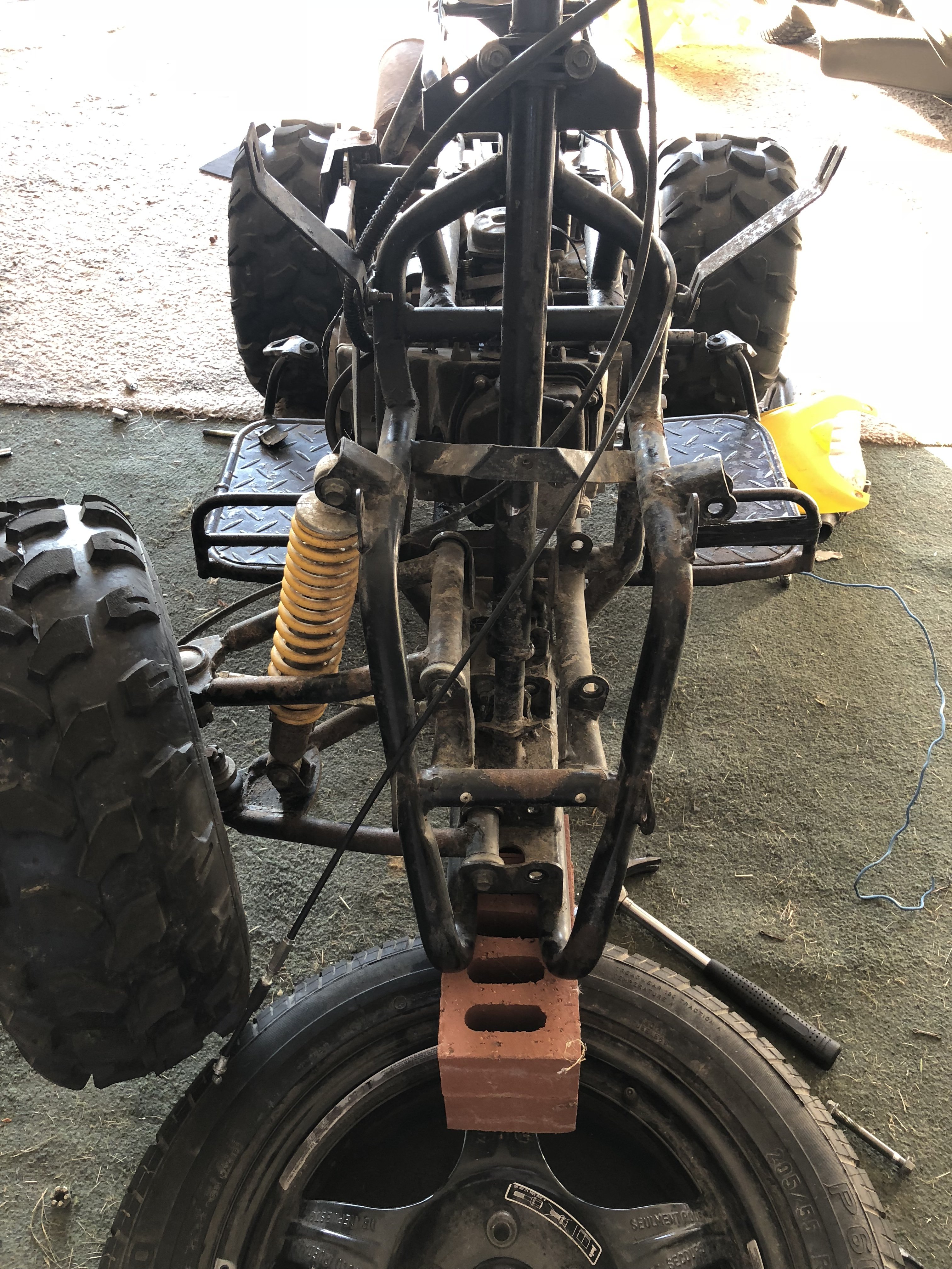

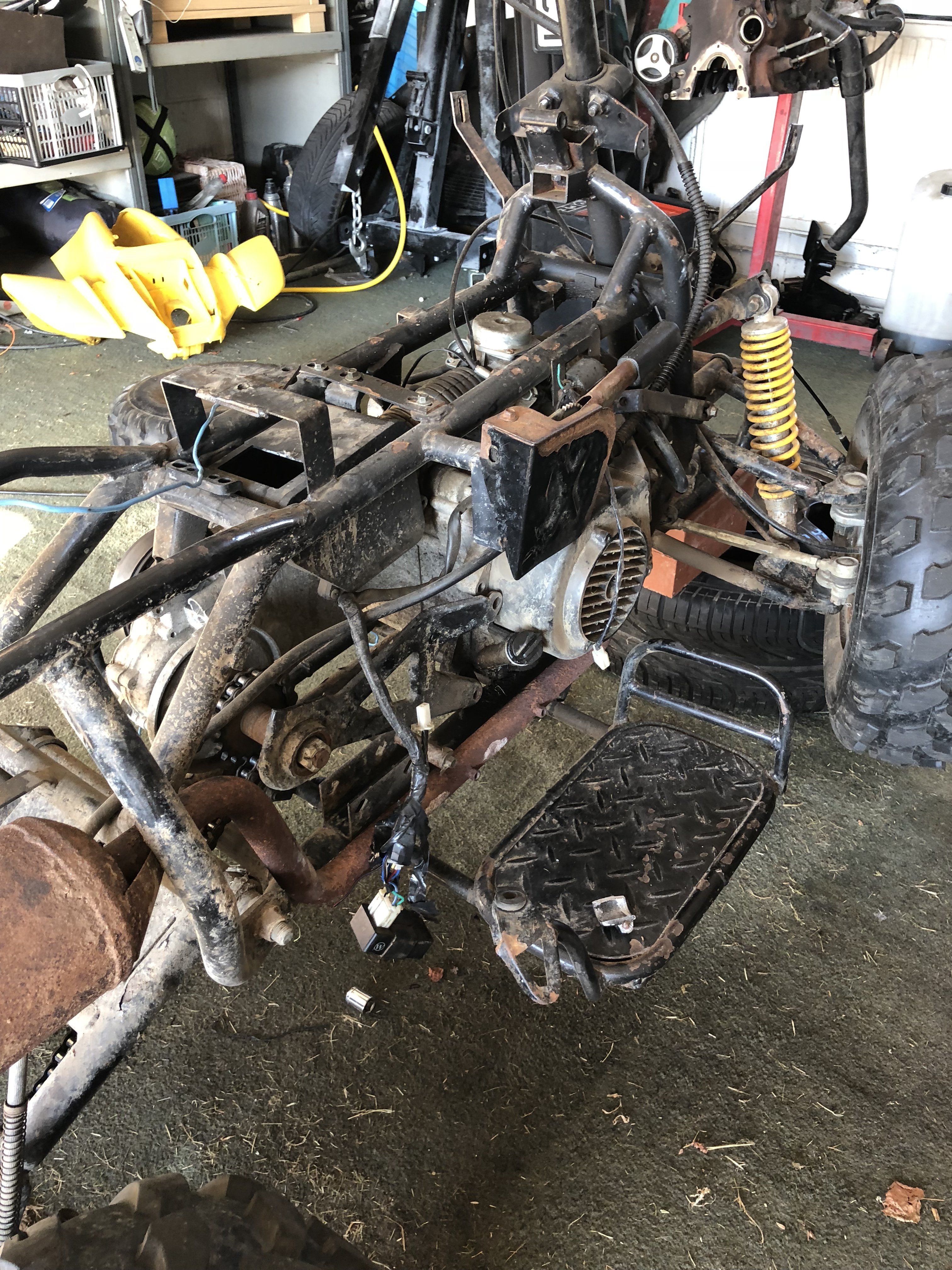

Hi I bought my son an old quad but I can get parts as everyone tells me I need a model name.
the model number has been removed so I’m sort of stuffed but I need a few different parts to get it running again.
can anyone help by the pics please.?
I'm betting it is a Taiwan made 2 stroke 90. If so they were sold under many names (Dinli, DRR, Manco etc) I have a Manco that I used Polaris 90 parts when I rebuilt the engine. Id suggest removing some of the plastic covers off the engine and see if you find an engine model number

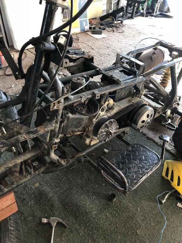

Looks like GY6 engine. It should have an engine number on the left side of the engine ans a VIN number somewhere on the front frame. What is the lever on the rear end?
I don't see a oil cooler either (E-ton)
Tahj
Tahj
Is that lever on a FNR gearbox mounted on the rear axle? Have not seen one like that if so.
Definitely gy6 based engine. The box on the rear axle should be FNR. Since it's on the axle I would expect that to be possibly an early 90s model. The thing I believe will be the key to identify it will be the brake handle mounted by the right knee. I've been around bikes and atvs state side for 24 years and haven't seen one with that set up.
