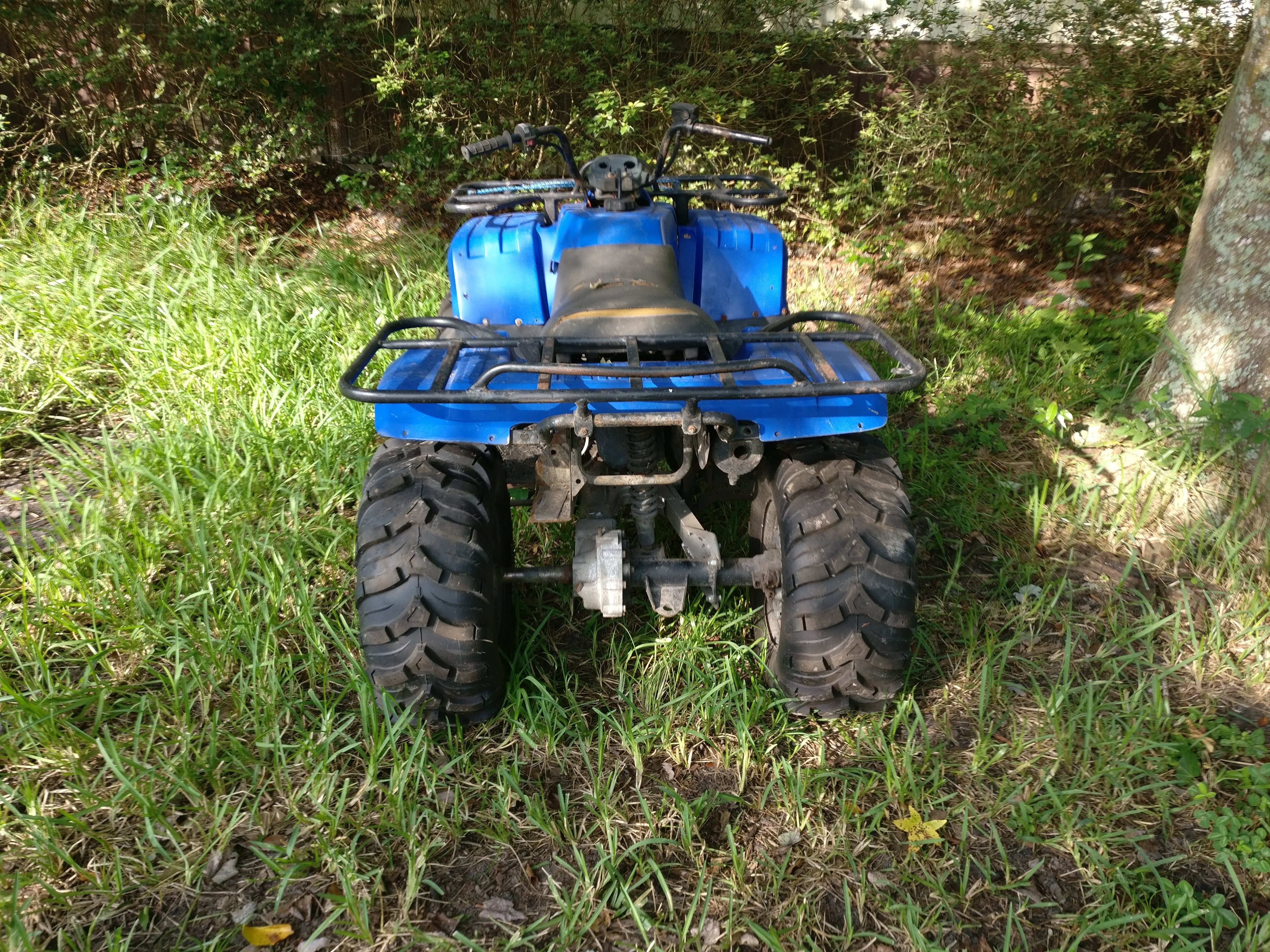

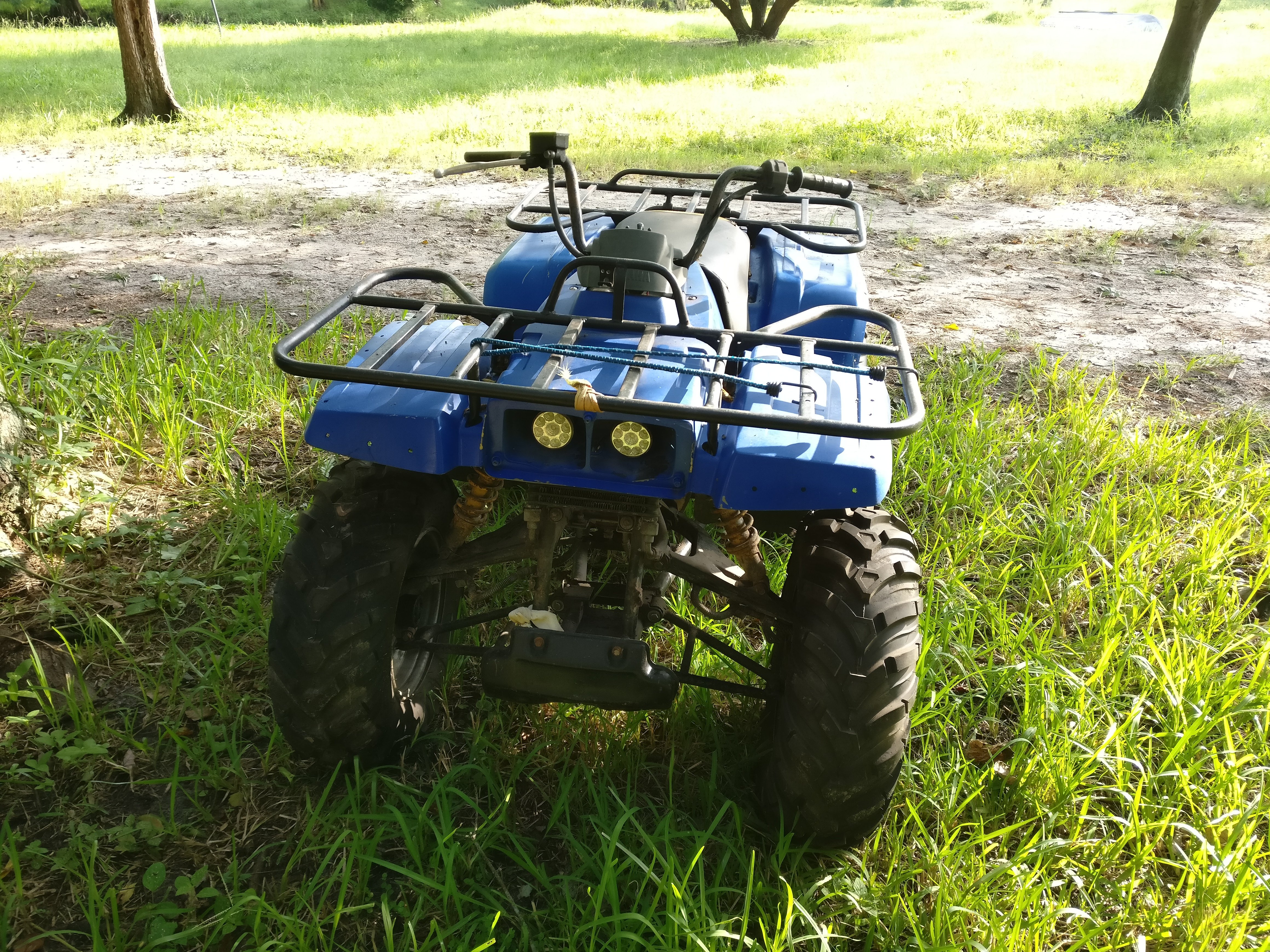

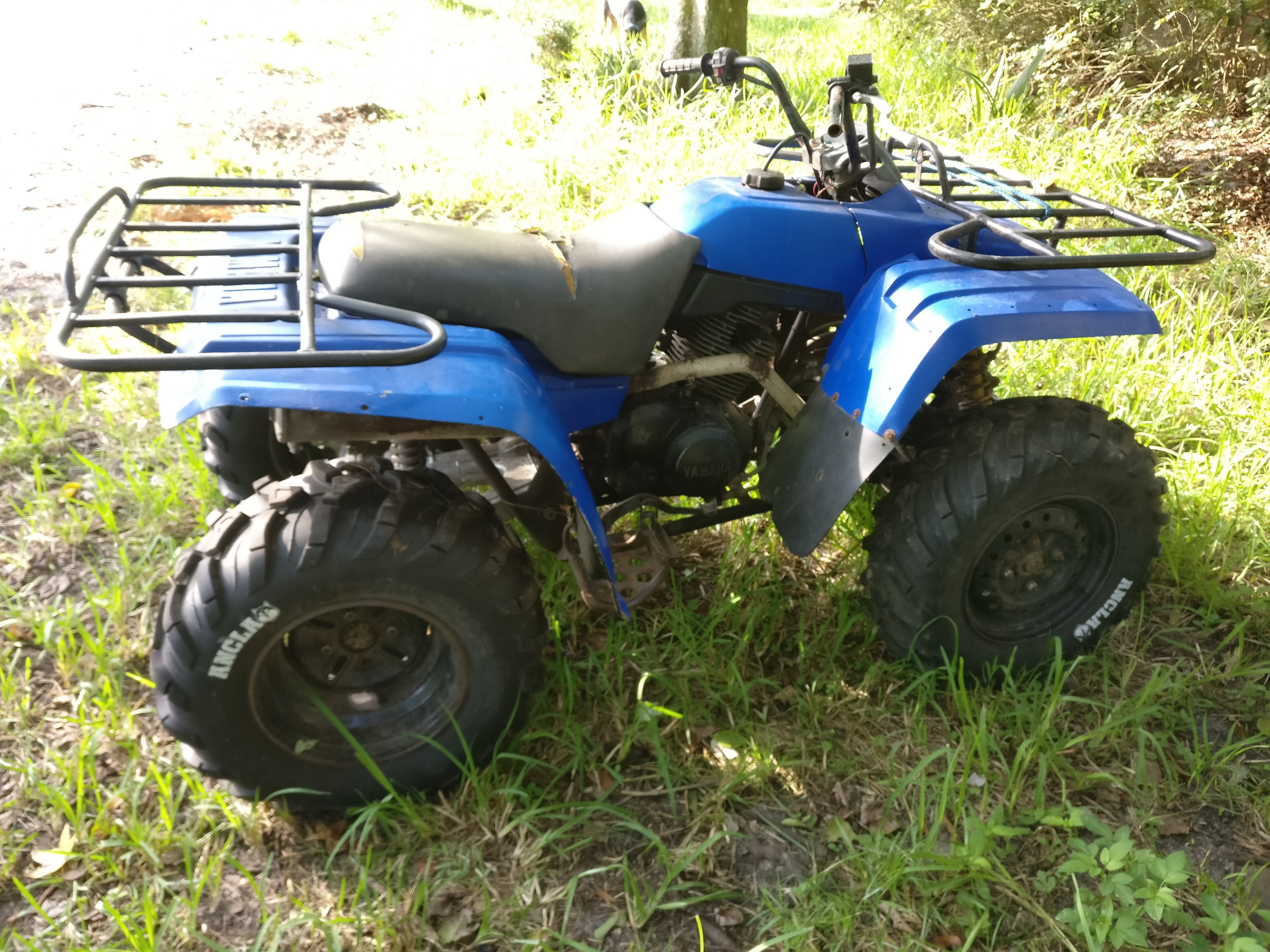

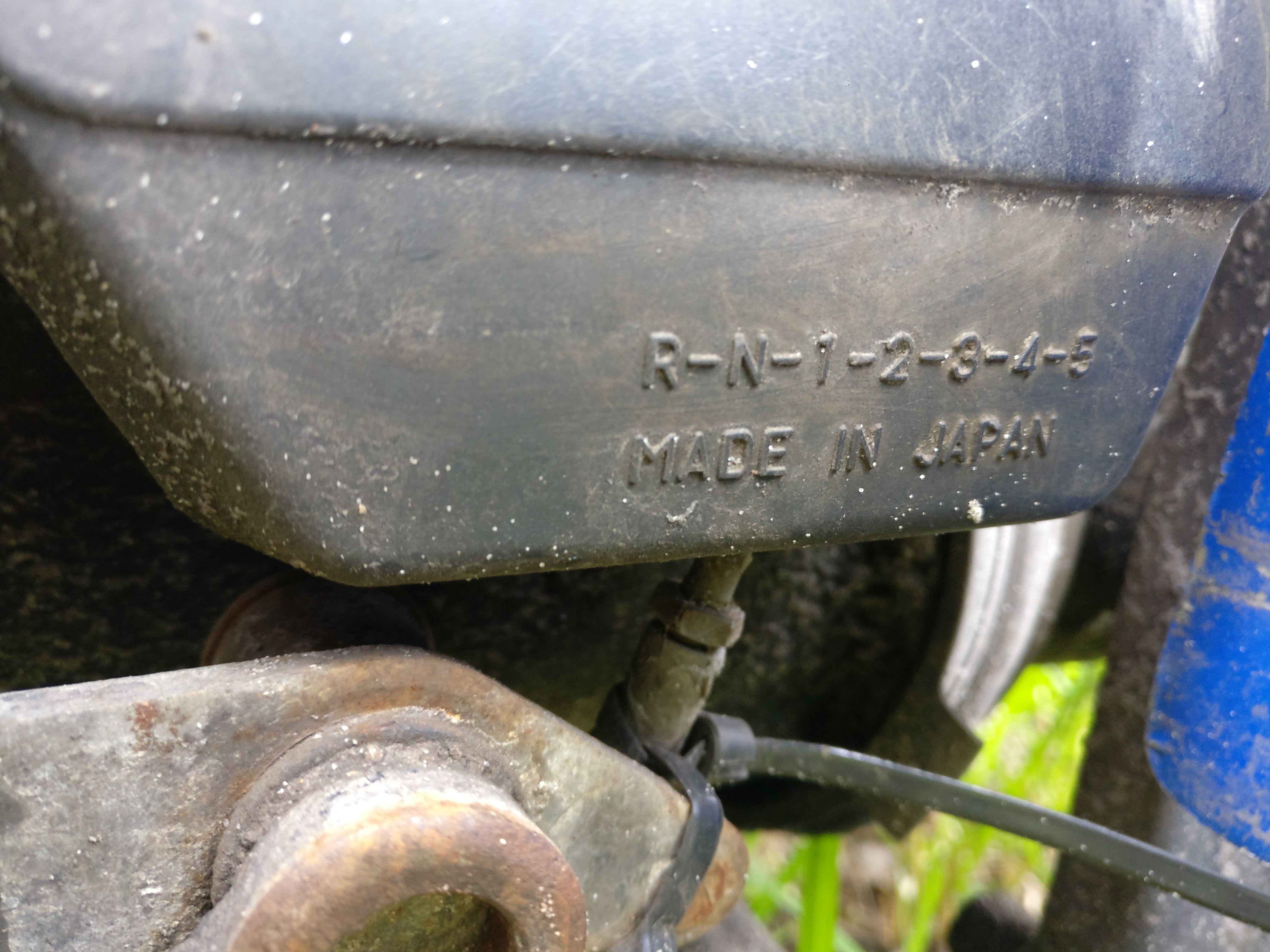

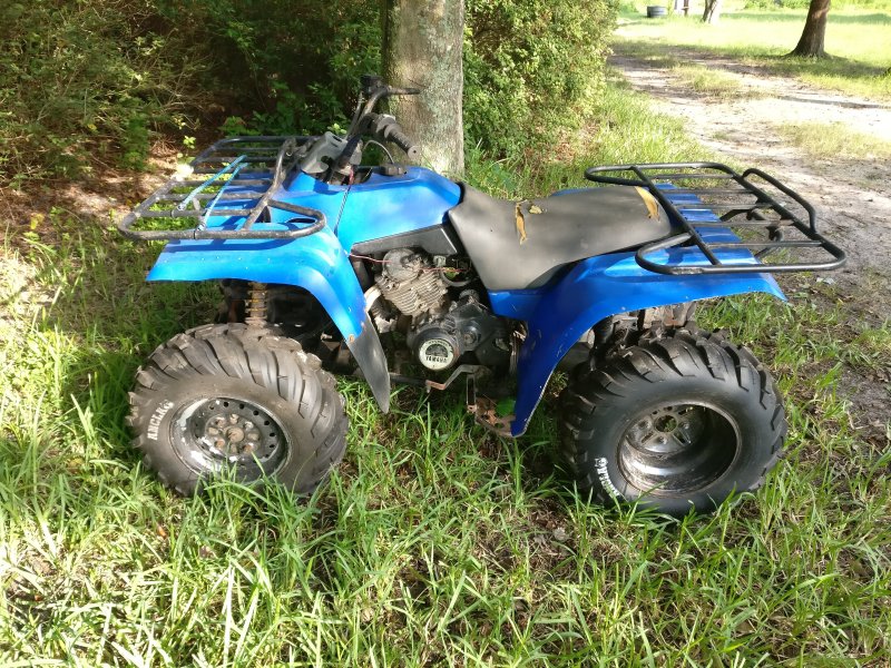

I just noticed that the VIN number is scratched out on it. Any other ways to determine the exact model? There are no stickers anywhere that I can see.
Unfortunately, the VIN is the best way. If it's scratched out, it may have been stolen and the thief tried to conceal it. Post some pictures and we'll try to identify it for you.  If you are looking for parts, just try to match them up and see if anything is stamped. Chassis and such will be the same for all Big Bears in most cases.
I figured it had been stolen. I am guessing that it was done awile ago. Its been painted over and rusted since. I will get some pictures up today. Any particular angles that will help identify it?
Side view (to see seat and plastic), front view, and rear view. If you see any numbers stamped anywhere like on the motor or any tags on the plastic, take a picture also. 😁

If you're still trying to determine the exact model, and all the stickers are gone, try looking for embossed or printed part numbers on parts that are likely to be specific to that model, such as plastic body panels.
When you find one, google that part number and part suppliers will list which years and models it is for, and you can narrow it down.
You will also find them on metal parts like shock bodies, ball joint caps and bearing races.

Here are the pictures.
Looks very similar to the Moto 4 350 I have. The Hi Low Reverse lever appears to be missing from the left side picture.
