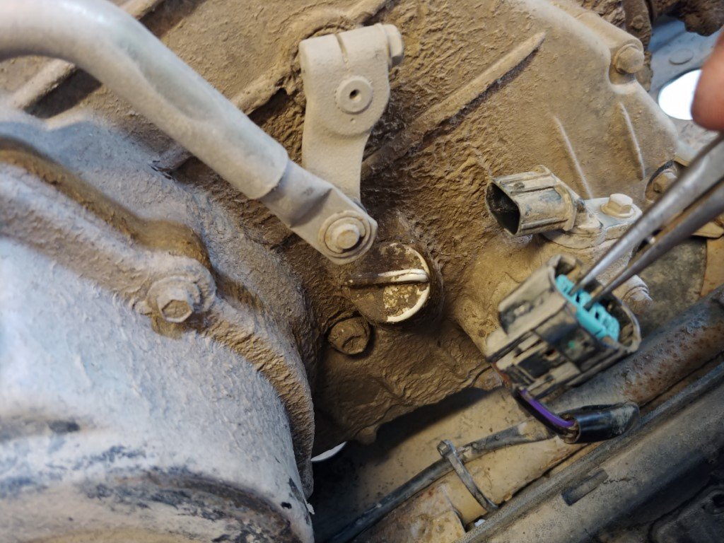

I do not know if this information will be accurate for you but last year I had a problem with my Arctic Cat 366 which is basically a Kymco MXU 375. There is a speed sensor that sends pulses to the POD to measure speed. (Picture 1) I had the same problem, reading zero. First picture is what the speed sensor looks like ON MY QUAD. It MAY be the same on yours?

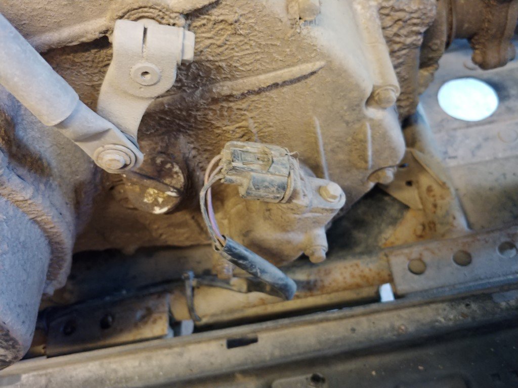

First thing to do is unplug it, clean it with electroclean (you can find it at any auto parts store) then measure with the ignition on to verify it has power to the sensor.  (picture 3)

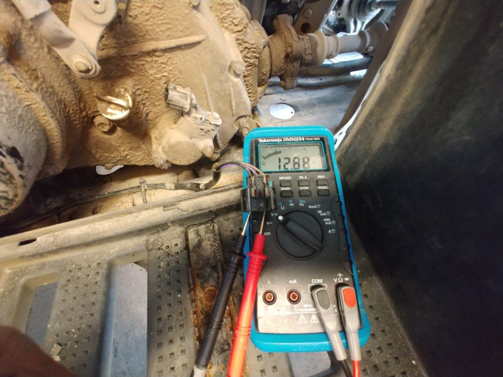

I have a meter that can measure Hz and I was able to verify the speed sensor was bad with it quickly. There is another way. Look at Picture 2. With the ignition on take a thin pair of needle nose pliers or use a piece of small gauge wire and go from the +12V lead to the center lead and "tap" it several times. This will simulate the pulses sent by the sensor. If you POD shows a speed reading, the sensor is bad. If it does not. You may have a broken wire or a bad connection to the POD, or a bad POD.
(My meter showed me with the quad running at idle, I had pulses coming from the sensor, but the voltage output was too low for the pod to read)

So if I tap the leads with pliers do I tap both at the same time or leave on one lead and you said if the speed goes off of zero that means the sensor is bad ?  And if it doesn’t move off of zero it could be the screen?  And yes the sensors look identical. Thanks for the reply
Either way, since I had thin pliers, i tapped both at the same time. (make sure your going from the 12 volt wire to center wire.
If it doesn't do anything, I would suspect the wire first. This quad did have a wire harness problem in the front side. It was intermittently blowing the ignition fuse and I found a rubbed through wire in the front frame. If you have a schematic, you can disconnect the pod and verify continuity between the speed sensor plug and the pod.
Its possible the connector to the pod is dirty and not making a good connection. I would suspect a pod problem last.
