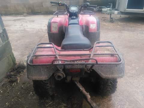

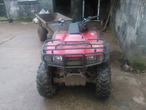

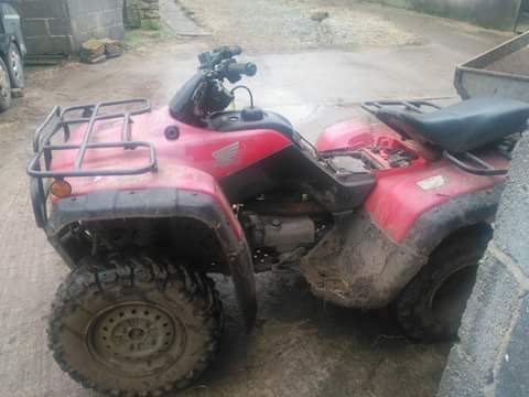

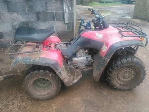

I  can't tell you the  model  or exact age,  but it is   definitely 2000 or  newer. Before  2000 they  did not  have  any instrument panel. I would  guess between  2000 and  2003.
