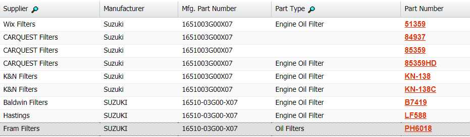

Im new to the forum and the quad I just got. I want to change oil in in. Its almost impossible to find anything on-line. I know it takes 10w40 and know the oil filter location. What oil should I use? Is there a cross reference for oil filter. The closest dealer to me is an hour away. I have NAPA close and like the WIX or Napa gold filters. Also is where can I get a Manuel for it? Thanks

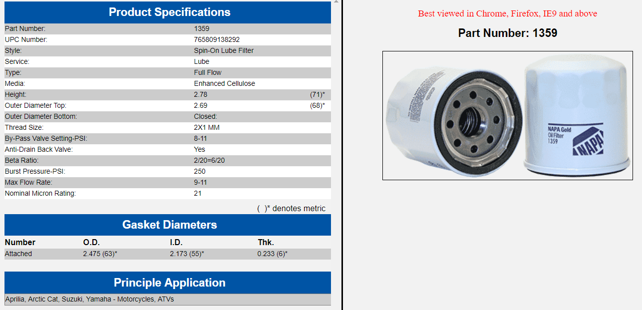

I also changed oil with the Napa Gold 1359 and used the Ams Oil 4 stroke ATV 0W40 oil. I changed the plug with a NGK 6965. Man what a difference a plug can make. Its like a whole new beast(what my wife calls it). This thing has loads of power. I had a Polaris Predator 500 back in 03 and this is just crazy more power. The throttle isn't as touchy but very controllable, which to me is better. Now to start powder coating stuff on it. Ill post pics when done

I have a (new to me) 2008 750 AXi.  I use 0W-40 Mobil 1 which is readily available at most stores of one of the world's largest retailer.  Thw WIX filter is good, too, and is available from the world's largest online discount company (so is the oil).  Availability is important to me in Alaska.
