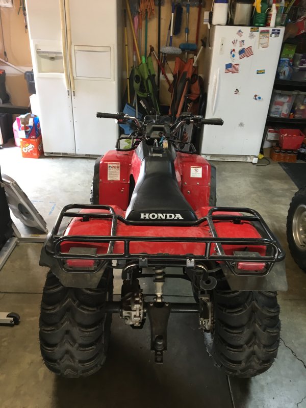

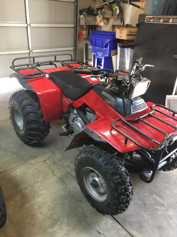

A 1986 fourtrax 250 has been collecting dust in my garage after I pulled off the final drive. The engine is still good but the drive shaft u-joint and final drive are shot. I hate to scrap the thing, but I also don't want to spend more than a few hundred dollars getting her running again.
Suggestions?
Sent from my SM-G935U using Tapatalk
If the frame, plastic, tires, and all is pretty good I would try and salvage it or sell it before scrapping it. Have you taken a look to see what it would cost you in parts new or used? Got a picture of it?
