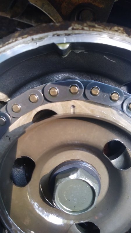

Okay I just wanted to get a good idea where everything was this morning so I started with the timing checked it, it looks like it's about 1/16 or 1/8 off is it as simple as removing the center bolt in the Top Gear and then turning the gear without turning the chain that far and bolting it back up
I  haven't  had  to  mess with  the  ignition and  cam  timing  on a  quad  motor so  I  cannot be sure ,  but I believe  the  sprockets are  keyed to the  shafts  and  are  not adjustable.  I  believe  about the  only  thing that  could take  them  partially  off  center  would be  wear  on the   sprocket teeth  and  chain stretch..   Neither  should  have a  great effect  on the  timing and  how  the  engine  responds..  If  the  chain  jumped  a  tooth or  more due  to  wear  and  a  loose  slack  adjuster, I  believe  the  timing  would be  much  farther  out and the  motor  would  be  greatly effected  at  all speeds from  idle  up.
I  don't  believe  that  is  your  problem. The  most likely  is fuel  problems , with  a  much  less likely possibility  of weak  spark.

 okay that's good to hear I was rather gun-shy about messing with it anyway I like to know exactly what I'm doing before I go messing with something and the chain is very tight so I doubt it could have slipped anyway never know though. Of course my starter had to go out and I'm having a little difficulty pull starting so kind of at a standstill thanks much appreciated
