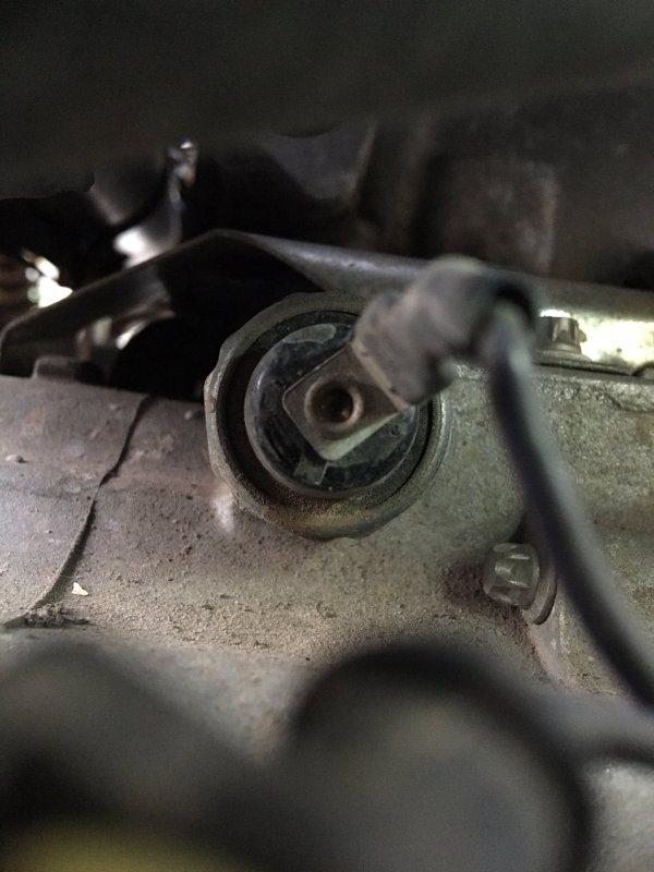

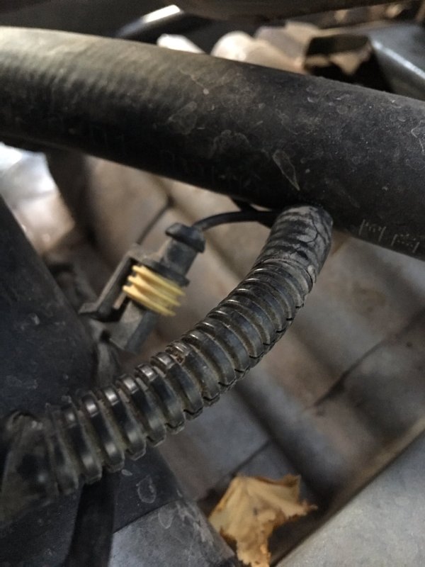

  2. There is a cable in the top, front of the engine that splits into two connectors. The connected side is in the photo. The other side has the yellow banded section and is not connected. I do not see anything in range of this connector so I don't know if this is normal or not???
  3. The original carb wasn't really dirty or clogged. I'll use it as a spare.
  4. I don't see this cable and connectors listed in the Can-Am shop manual. Looking for some help.

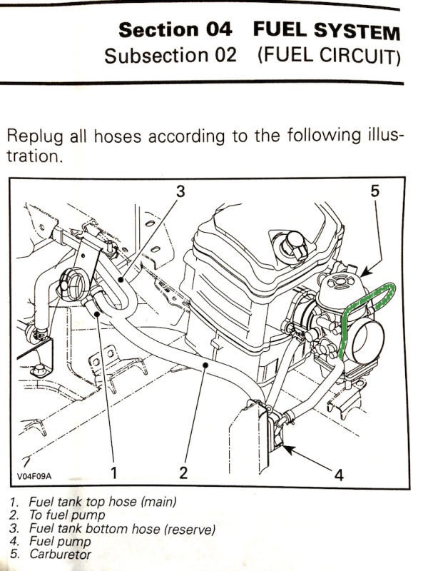

I did notice the hose on the throttle side of the carb that just dangles there. Is this supposed to connect somewhere? It doesn't appear to connect to the air box for example. See green arrow in picture.
I'm  not  familiar with the setup  on that  carb  and  motor   but  I'd  guess  maybe  the  dangling  hose  fits  the  carb where  the  black  cap  is?....Just wondering if it  fell  off  the  original  carb  since  you  indicate  it  was open  there  rather than  capped. Where  does  the   connected  end of the  dangling  hose connect? That  might  give  you some  clue ...
I  can  only  make  guesses  from   the  symptoms  described and  those  symptoms  point  to  a vacuum  leak  or  blocked  jet .. Since the  carb  is  new ,  then  I would  guess  a vacuum  problem ,  but  from  where I  can't  say .

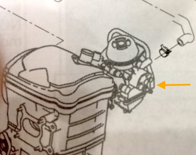

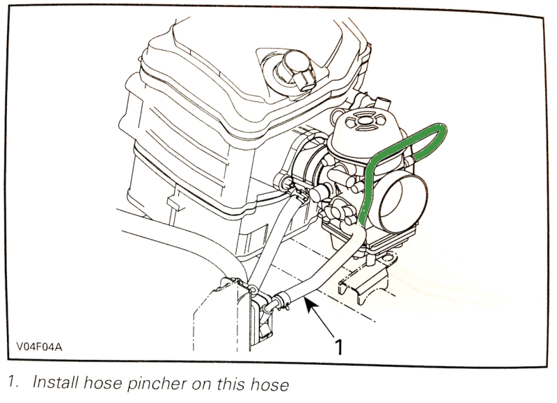

So I literally flipped through my 2002 Quest shop manual and reviewed all the diagrams and pictures.
On pages 04-0205, 04-02-1 & 2 there are some details that show the hose attached from the throttle side and going over the carb and down by the fuel intake line.
There is no connector there between this vacuum hose and the fuel line, so I guess it just hangs in this location. See green line in images. If you have a picture of this and looks different please post it. thanks!
It  looks  from  those  drawings the  fuel  pump  is vacuum  operated by  the  hose  connected in the intake right  at  the cylinder  block ..   Could there  be  a vacuum  leak  there  ?  I  have  no  idea  on  the  green  hose  and  have  no  pictures  other  than  what  you  supplied  to  make  any  guesses  from.

That's  the  best  I can  do   to  help. From  other  forums  I  gather  the  problem  can  also  be  from  a  rev  limiter not  reading a sensor right , or  a bad  sensor so  maybe  a  check  of the  wires   to  the  various  sensors  is  also  warranted.
Thanks. I am going to take another look at all the wires. That could explain some of the sudden issues after it appeared to be working (mostly).
I am confident the green hose is just supposed to hang in place now... I found another drawing that shows it does NOT connect to anything at the base of the carb. See picture. I am going to assume the cap on the other side should be in place since it appears to be a black rubber cap like all the others.

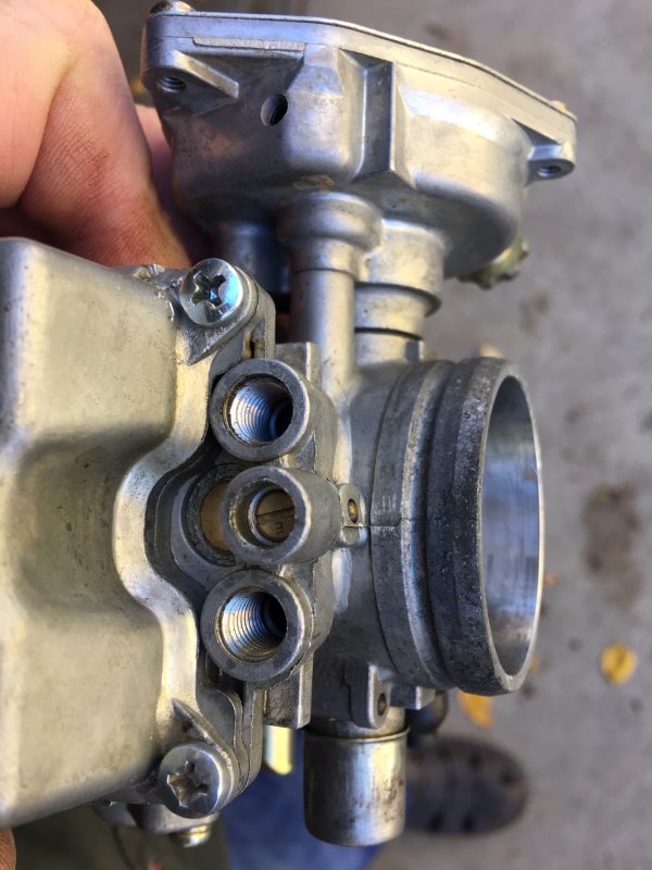

The original carb and the new carb don't have any connections at the bottom. (see picture of original carb) I think this may be the issue... I see some pictures where a new, stock carb has a brass screw in the throttle side of the carb next to the pilot screw. I don;t know if this applies to the can-am carb or not.
The problem is I have never seen these connected, so I don't know the correct setup. I can't find an image or drawing showing any hoses connected to the bottom of the carb.
Anyone got a picture of this from the bottom?
